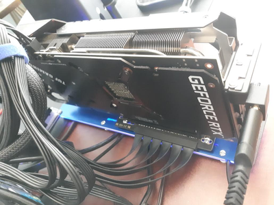

09-10-2022 03:49 PM
Dear Forum,
Completed installation of RGB-LED blue colored external graphics stand + added sturdy metal graphics card bracket to provide better support for the RTX 3080 OC 12GB graphics card:
Kind Regards,
NonSequitur777
