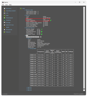

Btw, the 4 x 8GB 3200 MHz Samsung RAM in my HP EliteDesk 800 G5 SFF runs in dual mode and at 2666 MHz, which is the fastest my i7-9700KF can run RAM on this platform: Intel® Core™ i7-9700KF Processor:
It is indeed true that better tunings can be achieved using fewer sticks, such as this 2 x 16GB RAM example: HP EliteDesk 800 G5 SFF Performance Results - UserBenchmark, which achieved 93.7% for RAM performance, compared with my 88.9% RAM performance.  However, this RAM performance difference is irrelevant for gaming purposes, especially considering that my RTX 3080 has 12GB of fast GDDR6X RAM on board.

Not dual channel.  Dual rank.  Due to a quirk of Intel memory controllers they can access both banks of a single stick seperately, which can help with latencies.
I know you are in dual channel.  But take a look into dual rank as well.
Check out HWINFO and see your rank layout.
Edit: I see you are also in 2T, whereas 1T is preferred (possibly due to 4 sticks).  Just letting you know there are tunings you can do even on this motherboard to improve benchmarks.
