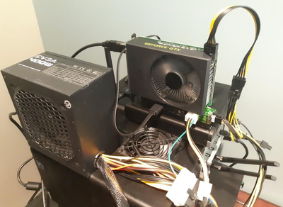

The NGFF M.2 A/E Key Cable adapter came in and wanted to install it in order to try out an external graphics card.  To that end, used a backup heatsink for the HP EliteDesk 800 65W G3 DM to put this mini-PC back together.  In order to route the adapter cable (the HDMI end) through the back panel to the "Beast" dock, I removed the VGA connector:
Setting it all up, using a synced EVGA 400-watt ATX power supply to power a Dell Nvidia GeForce GTX 1660 Ti 6GB GDDR6 graphics card:
And it booted right up through the GTX 1660 Ti. Installed the graphics driver:

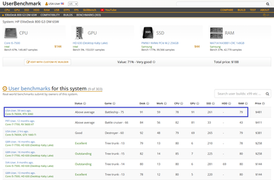

And benchmarked it through UserBenchmark: HP EliteDesk 800 G3 DM 65W Compatible Components, and already -without additional optimizations, scored #2 in the "HP System EliteDesk 800 G3 DM 65W":
Link: HP EliteDesk 800 G3 DM 65W Performance Results - UserBenchmark.

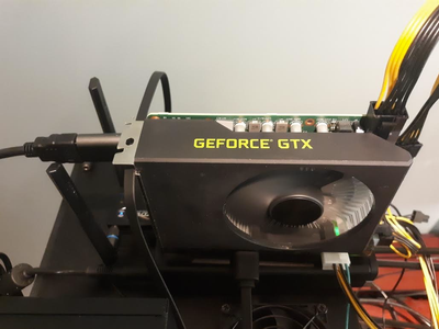

Mind you, the graphics card only "runs" (bandwidth) at PCIe x1 speed:
Even so, it performs pretty good as-is, IMO.  Once I upgrade this HP G3 mini-PC with an HP G4 mini motherboard, I will use one of its two M.2 NVMe SSD slots to use an M.2 NVMe SSD adapter cable to the EXP GDX Beast Dock to achieve PCIe x4 speeds, which will provide more than sufficient graphics bandwidth to smoke the competition.

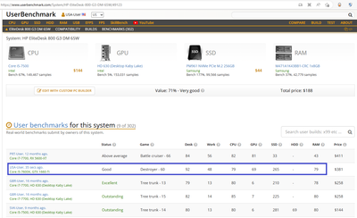

Replaced the GTX 1660 Ti with an HP Nvidia GeForce RTX 3060 12GB GDDR6:
And reran the UserBenchMark performance test -scoring first:

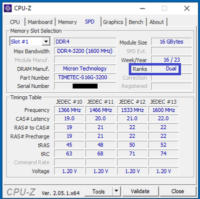

@C0mputerH4ck,
Your comments about dual-rank RAM prompted me to research this topic in more depth.
Long story short: you convinced me to go this route:
Btw, this RAM is intended not for my current (HP EliteDesk 800 G3 65W DM) upgrade project, but for my follow-up "G4-DM" upgrade, which is going to be fitted with an i7-8700K, with max 2666 MHz RAM speed.

@C0mputerH4ck,
The "Timetec 32GB KIT(2x16GB) DDR4 3200MHz (DDR4-3200) PC4-25600 Non-ECC Unbuffered 1.2V CL22 2Rx8 Dual Rank 260 Pin SODIMM" RAM showed up, and installed successfully:
