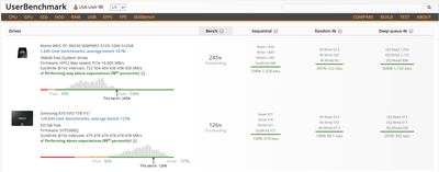

Also going to upgrade the primary (boot) drive to a much faster AND competitively priced 1TB Crucial P3 Plus Gen4 3D NAND M.2 NVMe SSD, with read/write speeds up to 5,000 / 4,200 MB/s, though this drive will run at lower Gen3 I/O speeds in this PC:

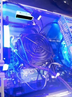

The 125-watt HP LGA1700 CPU heatsink I had also purchased didn't fit, so I 'modded' the existing 45-watt heatsink by replacing the single 0.50 Amp cooling fan with dual 0.65 Amp Foxconn (p/n: PVA080G12Q) cooling fans:
I have had good results with stacking cooling fans on HP stock CPU heatsinks, as the airflow through the CPU's heatsink cooling fins increases markedly, thus keeping temps down.
