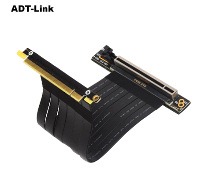

The ordered PCIe x16 right-angle to PCIe x16 extension ribbon cable arrived, and reinstalled the 1TB Samsung 980 M.2 NVMe SSD:
Removed the HP PCI Extender Slot Kit (p/n: 696971-001) and the RTX 2080 Super, connected the PCIe x16 right-angle extension cable on the PCIe x16 (wired as x4) slot, reinstalled the GPU over the extension PCIe x16 right-angle ribbon cable, and used self-adhesive Velcro strips on the M.2 NVMe SSD heatsink to secure it to the desktop case:
Then used Macrium Reflect to clone the primary (boot) drive (500GB WD SN550 M.2 NVMe SSD) to make the 1TB Samsung 980 the primary (boot) drive:
This procedure is ridiculously easy and straightforward -follow these steps: (530) How To Clone Your Windows Boot Drive With Macrium Reflect - Easy and Free Software! - YouTube. Lastly, access BIOS (F11) and change the boot order to make the newly cloned M.2 drive the primary boot drive. Then restart -the new drive should show as the "(C:)" drive with the Windows icon -see picture above, check that the newly cloned drive has all the data you expect to be there, and then do a quick format on the 'old' drive to remove Windows and everything else.
