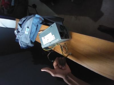

Esta es la fuente que planeo instalar
Está es la foto de la caja
Hi Jaiverson. yes the picture is different as the last 2 wires in my p2 plug are jumped out. My original plug had only 4 wires. one white & the last 2 slots being empty. This plug has only 3 wires & a jumper.. It works fine on my pc The description does say that it will work with the Compaq 6200 mid tower but I don`t know if that applies to a 6200 PRO mt.COMeap adapter.jpg
I'm going to try it I'll update again in the post to say if it worked or I screwed up the board🙃 but I promise it will work .Some vendors with the same cable claim that it works with the 6200 pro
