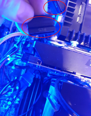

So the power supply arrived and it is the expected HP part number (942332-001), but it unexpectedly has more power cables than we thought.  It has two 4-pin connectors, two 6+2 pin connectors and the small 7 pin connector:
https://drive.google.com/file/d/1fb9ez1W1dWhVkuNEeDG7N6aam7kyod6P/view?usp=share_link
Since this is the case, do I even need to use the extra adapter cables?
@raynebc,
That is excellent news: no, in that case, you do not need the extra adapter cables!
And, as mentioned, a 400-watt power supply is more than sufficient to power a GTX 1660 Super.
Kind Regards!
NonSequitur777
