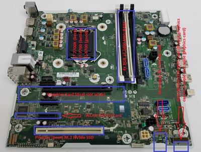

If your white PCIe x16 (x4 wired) slot is available, I would use that slot for your PCIe to NVMe adapter.  In my case, the graphics card mounted in my HP ProDesk 600 G4 MT's black PCIe x16 slot -because it is a dual-slot graphics card, covers up the PCIe x4 slot, so that slot is not available to me.

The x4 port is so close I'm not sure the PCIe NVMe adapter will fit without pushing against the video card, so I put it in the secondary x16 slot (the white one on the edge of the motherboard) as per your recommendation.  CPU-Z claims the graphic interface link width is x8 (the computer must have allocated half of the lanes to the second x16 slot even though it's only an x4 device).  CPU-Z said that the GPU's link speed was was 2.5GT/s, and GPU-Z said the card was running at PCIe x8 1.1 and that worried me until I ran the render test and it bumped up to PCIe x8 3.0.  It doesn't seem like this bandwidth limit will matter even for rendering with Blender, so I'll just shrug it off.  I'm more worried about the HDMI signal stability.  The video kept dropping out, and the 8 pin connector on this PSU seemed kind of finicky, like depending on how hard I pushed in the connector, it would fail to boot with a PSU related beep code sequence.  This PSU (the one that was refunded) may just be faulty.  The one with the correct P2 connector should arrive in the coming days.

Here is my HP ProDesk G3 MT motherboard components recommendation:

I was thinking about the wifi arrangement.  Since the video card does block access to the PCIe x1 slot, I can't use my old computer's wifi card.  In a previous photo, you recommended the ax210ngw dtk wifi card.  Can you confirm this is a compatible M.2 card I could install to add Wifi to the computer?
https://www.amazon.com/AX210NGW-Supports-Tri-Band-Antennas-Low-Profile/dp/B088NHCX46
