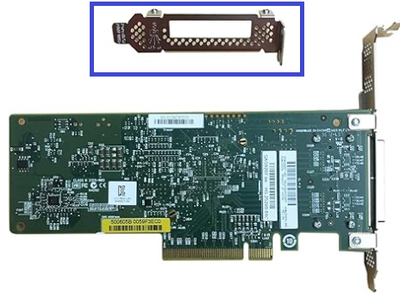

Can I ask you, I also want to add a LSI HBA card to attach an external disk enclosure. This will be something like a LSI 9207-8e low profile card. I was initially planning to use the x16 slot for this so I could get full bandwidth for storage drives. But with the gfx card going in that, it only leaves the x4 one, would that be ok?

03-09-2024 09:11 PM - edited 03-09-2024 09:14 PM
Adding an LSI 9207-8e Raid Controller low profile card in the (white) PCIe x16 (wired as x4) is the way to go -plenty of bandwidth, no worries:
