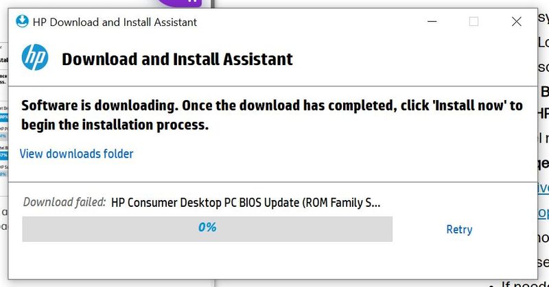

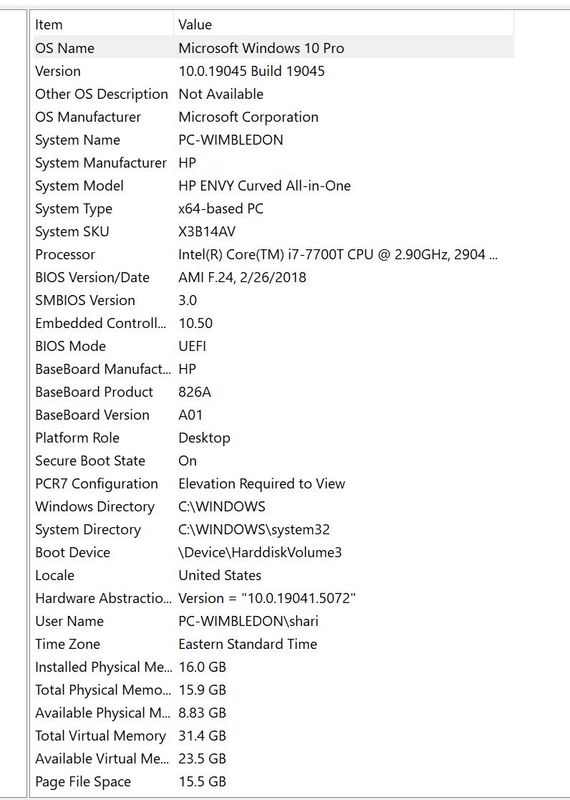

Hi, I just tried to update the BIOS. It failed.
See images. It shows my system info, my current BIOS version, etc.
And the failure popup.
Suggestions?
Is the updated BIOS compatible with my system?
thanks
Steve

@saz25,
Let me check something first.
Please type in: system information in your lower search bar.
Click on the System Information app.
Look to the right of: "BaseBoard Product".
Does it say: 826A?
Kind Regards,
NonSequitur777
Yes if you notice on one of the screen shots I posted, it says 826A.
thanks
Steve
