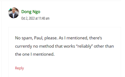

I had reported the issue of the bypass no longer working to Dong Knows Tech on Sept 20th and followed up today with this video (thinking he would be appreciative of it), and he marked my reply as spam with the reply that the revised method he described to upgrade to W11 22H2 was the only reliable one that would work.
I guess he didn't want any other suggestions to be posted there unless they were 100% effective.
That was the first and last time I will ever offer any suggestions to him.
@Paul_Tikkanen,
Yea, no kidding, I saw that:
Even though he uttered words of high praise for you on September 20th:
Thank you, Paul, for all you do!
Much appreciated.
Kind Regards,
NonSequitur777
Thanks for the compliment.
I was flabbergasted for having been chastised like that, but decided to keep my keyboard shut. 🙂

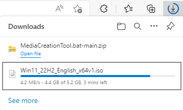

I upgraded 2 of my HP 255 G7's to W11 22H2 using the new procedure and those upgraded fine.
One of them hadn't worked twice before and now I have come to the conclusion it was more my problem.
I used a modified W11 22H2 bootable ISO file that I made with Rufus 3.18 (there is an option to select no TPM, no Secure boot and it works fine with clean installing with a USB flash drive on an unsupported PC.
I plugged that into the PC's USB port instead of downloading the standard W11 22H2 file from Microsoft, and I think that is the reason the upgrade failed before.
This time I just downloaded the plain W11 22H2 ISO file, ran the hack, clicked on the ISO file's setup application and off it went.
So now the score is 5 successful out of 6.
I can't redo that on three other PC's, because I have already clean installed 22H2 on them with the modified Rufus utility.
But I can re-do my HP 8000 Elite CMT and see if that goes well the next time.
If it does, I am going to consider it a reliable way (despite what Dong thinks) to either go from W10>W11 22H2 or from W11 21H1 to W11 22H1.
