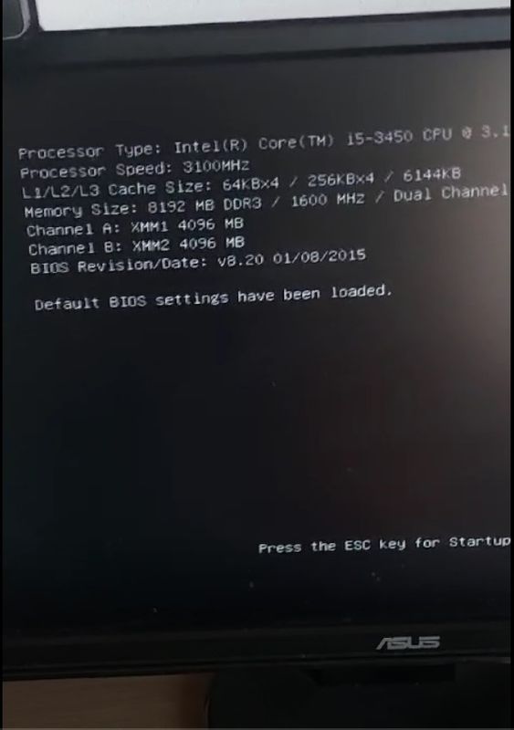

We have a big problem. I looked onto other posts and some had this bios update installed on the same mobo. When I entered the setup, I accepted the agreements and then it instantly went into cmd without making sure I eould want to update. My mouse wasn't working anymore (due tot update I think) so I couldn't do anything anymore. It made the thing I hoped wouldn't happen: erase and flash the old version, of course! It updated it and automatically restarted. Now every time it powers up right before giving signal on the monitor it SHUTS DOWN, powers up again, shuts down again right before giving signal and it is an infinite cycle of this. Now any other option I could do? Get an USB and try to put the old version (7.12 if my memory is correct)? Will it be dead from now? I just shut down my outlet so it could shut down...

Hello Sir. After the little replies we had a while ago, I've decided to call my parents and tell them to plug the computer in the outlet again and give it another try. This time, guess what, it worked! They've recorded the screen for me and I saw the hp Boot Startup being a little different than it was, then the motherboard gave the me the message in the photo I attached. Looks like it loaded the basic BIOS settings and restarted again (without forcly shutting down) and booted right into Windows! I told to go into System Information and see if it really loaded tha BIOS version and clearly did! (8.20 Rev. A). The boot mode is still Legacy, so that means that I still can't put a Higher GPU than the 600th Series, right? But the most important thing is that the PC works, and I have a kind of UEFI version on this ''Legacy'' motherboard, so I want to thank you for your help and hope the answer to the GPU question will be an affirmative one! No matter what now, I will mark your comment as a solution for this.

Yes that shows the new BIOS updated properly. It will allow the graphics card choice you had hoped for,(assuming you do not exceed the 300w powers upply) it just needs to be changed to UEFI from inside the BIOS.
In order to change it from Legacy to Secure (UEFI) start tapping the Esc key before the start button is pressed, then kep tapping the Ecs key until a pop-up menu appears. Then pick F10. The System Configuration.. Then there should be a Boot Options category. Click on that option while in the System Configuration tab. As you look down the list, you will see the Legacy option and then under that is the Secure Boot. Click on Secure boot and then Enable. Press Ecs and the F10 to save the setting and then reboot. Repeat the Esc tapping on boot-up and then F10 again, you should then seen the Secure Boot is enabled.
