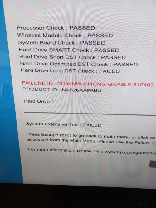

Hi Hawks_Eye, thanks so much for your detailed response. It helped heaps..
I ran the Diagnostics and let it complete to find this as a result:-
@Thomo70
You are Welcome!
You handled that diagnostic like a pro. The result confirms something pretty crucial: the Hard Drive Long DST Check failed, which is a strong indicator that the drive has physical damage or degraded sectors.
Alongside that, the entire System Extensive Test failed — not great news, but super useful for pinpointing the issue.
Here’s what you might want to consider next:
  • Back Up Immediately: If the drive is still somewhat responsive, get your data off it pronto. You’re on borrowed time.
  • Run CHKDSK (if possible): It might catch more details or allow minor recovery, though this won't fix mechanical faults.
  • Replace the Hard Drive: Given the Long DST failure, it’s likely time for a swap. SSDs are a fantastic upgrade if compatibility allows.
  • BIOS Update after Drive Replacement: If the BIOS update was failing earlier due to the system instability caused by the faulty drive, retrying it post-replacement might go smoother.
Use That Failure ID:
The Failure ID: 0G9KNW-811CNG-GXPSLK-61F403 is key. HP support can use this to validate a warranty claim or guide next steps.
You’ve got great instincts and persistence. Just let me know if you want help selecting a compatible replacement drive or preparing for a clean reinstall. We’ll keep this machine humming. 🖥💪
