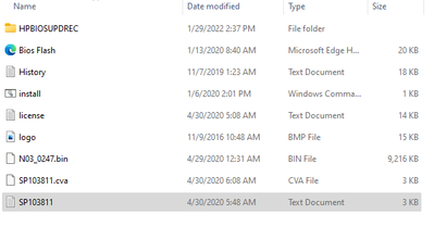

If your friend has a copy of the original BIOS then it should have a rom SSID number. Possibly a file ending in txt or rtf in that USB flash my be able to provide more info.
Could you get a listing of the contents of the file and post it here? The listing should include "detail" so that the date and time are listed.
for example
and the text file highlighted above shows the version in the first 4 lines
see if your USB chip has similar items. The name wont be the same.,
use the windows key + shift S to capture the listed from the windows file explorer
The fact that the system can boot that USB flash is a good sign.
If you try the Win + b and do NOT use the USB flash then the bios recovery software will try to find a copy of the bios on the hard drive. When you tried that did any messages pop up such cannot find the bios file?
