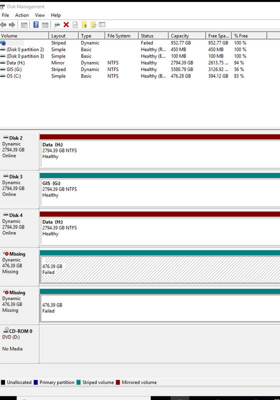

Update.  Yes, the bios upate appeared to do something to the drive so that windows no longer recognizes it.  In Windows Disk Managment, it now shows the two 'modules' as missing and failed. Failed_Striped_array_after_bios_update.png
Does anyone know if there is a way to rebuild the stripped array without losing the data that was on there?  Please help, I really need the info on that disk.
ps. I tried reactivating the disks to no avail.  They are still missing to the OS.
