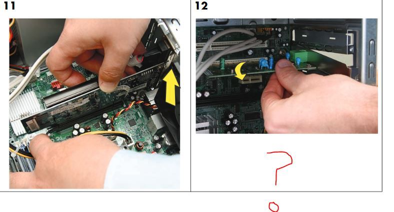

here is you PC , im reading your service manual, now,  not very good , doing many languages,,
see this guy, he bought THIS PC with the upgraded video card,
page 25
see the 2 red arrows, below.?  one is onboard video and on the right is addin card video.  test both.
to test both remove the card, and test onboard, if that fails put card back and test its VGA jack. (DVI, etc)

odd how the hp offical pages lack a full product  spec, ,
but that top slot is a x16 express slot
use any cheap x1 and above express video card there, as  a test.
why not tell the helper the x16 slot is empty first.
or that the fans all works and that , PSU fun works and the DVD tray ejects.

Chipset: NVIDIA GeForce 6150SE nForce 430
that slot is good for any 75watt video card or less,  says the maker. so find  cheap one to test this.
my guess is PSU dead, but, i can see it , hear it or do the tests for you..
the x16 can run any X1 to x16 card, only limits are HP bios rules , if it does, work. on all cards.  the foot note there on it is missing, sadly
