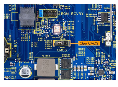

The motherboard has jumpers to allow reset of the CMOS without having to remove the battery
https://support.hp.com/us-en/document/c05939208
However many HP system are customized and there may be newer or different versions of the same mothererboard.
Please compare your motherboard to the one here
https://support.hp.com/us-en/document/c06124756
You can expand the "sunflower" and compare it to yours and also go the the spec of the sunflower like I listed above.
To clear using the jumper:  Unplug system from the wall.  Press the power on button and hold to for a few seconds to drain power supply.  Make an note of the jumper position so it can be return to the same position.  Touch the metal of the case with your finger before touching any part of the motherboard. move the jumper from the two pins it is on and to the other side..  After 30 seconds move the jumper back.
Turn it on and see if it works better.

I tried moving the jumpers and also removing the cmos battery and it's still boot looping. I've also tried reseating all of the components. Anything else I can try or is the motherboard just fried? Thanks
This does not sound good.
Did you unplug the system from the wall when you removed the battery?  You should also have pushed the on button for a few seconds to fully discharge the capacitors
Try the following
https://support.hp.com/us-en/document/c04126730
from looking at the image above your system is one of the few that allows programming the motherboard you might try this before junking it
