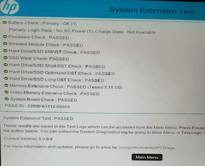

Thank you for your reply. I did a full HP System Extensive Test earlier today and everything passed.
Here is a picture of the results:

The diagnostic tests passed. This is good.
A reset did not fix the problem. This is not good.
So I think you have an intermittent power delivery problem. This means a power supply problem or a MB problem. You could have a component connected to the MB that is causing an intermittent fault. No way to isolate this in a forum. The other component fault would have to occur during hardware diagnostics.
