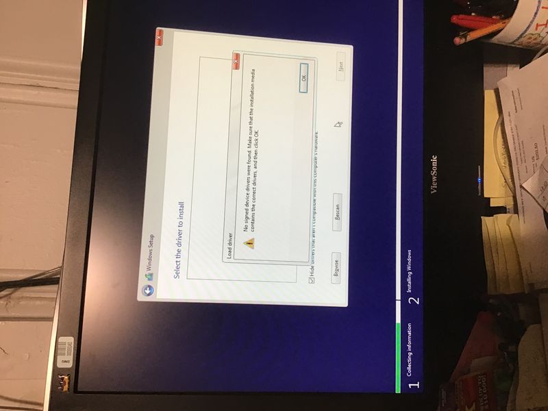

Media Creation Tool ? Was this part of the download onto the flash drive , or was i supposed to select it for the download? Am I supposed to redo download after deleting all files on thumb drive?
I hit rescan , and it’s taking awhile on Collecting information on 1 before 2 Installing Windows. Picture below at bottom
11-10-2021 09:21 AM
The setup procedure is running and you need a driver. This is strange because just recently I installed WIN10 on an very old Intel-Workstation from 2003!
You only find drivers vor WIN 8.
https://support.hp.com/us-en/drivers/selfservice/hp-pavilion-p6-2300-desktop-pc-series/5295969/model...
The last BIOS is from Feb 9, 2015.
You can try the AMD USB Filter Driver. But you have to extract the contents of the *.exe because you need *.inf-based drivers. I use 7-Zip for this.
Copy these files to the USB-stick and try again. It might be that during the setup you have to navigate to the drivers.
