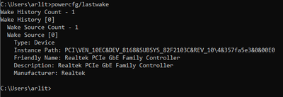

I tried it and it didn't help. The computer wakes frequently from sleep for no apparent reason. I ran the powerrcfg /last wake command in a command prompt and the message I get is
I can't find a way to find out or stop the PCIe Controller from waking the computer

The source of waking up seems to be the PCIe Gbe Family Controller as indicated when I do a command prompt "powercfg/last wake".  Is there a way to turn off  that controller?

Hi, I don't understand. What do you mean by connected?
I ran the "powercfg/lastwake" command  on the command line and this is my result
