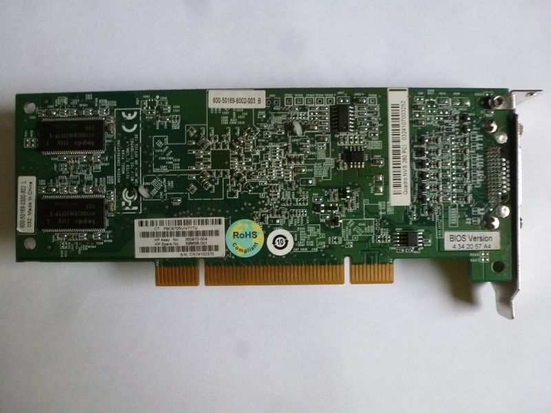

Photos of existing graphics card below.  Slots into a 3 1/2 inch white socket. Have not tried the existing headphone socket, JBL speaker is fine, so can't all be shot.  I assume whatever sound card there is , is actually included on graphics card.  There's an unused 3 1/2 inch white socket plus a black 3 1/2 inch, plus a black 1 inch socket.  From what I can glean online,  a sound card for music (or gaming, not my scene), with a proper Hi-Fi headphone output, slots into one of the spare ones, say the black 1 inch.  Maybe that's a way out, say up to £50, and would give good audio.
Unlikely to get that far though.  HP does wonders with photos!
So, somewhere on this Nvidia graphics card I assume is whatever supervises sound.  I cannot see anything labeled Sound

The graphics card in your screenshot is a PCI graphics card.  Not the best kind for performance, but it should work.
The good news with the PCI card is you should be able to use both the onboard VGA port and the AMD graphics card at the same time.
