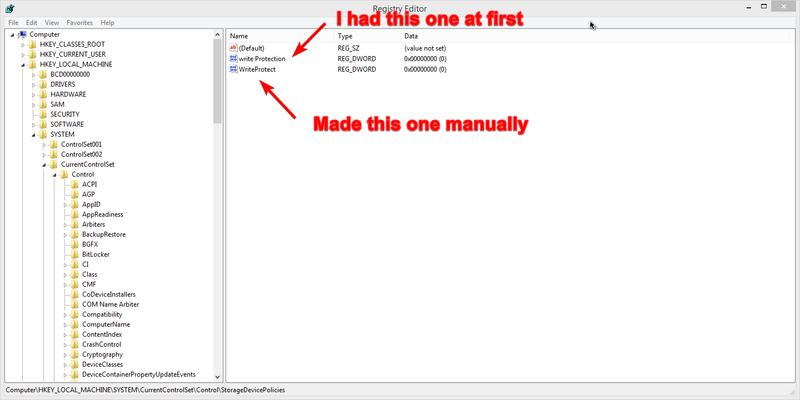

05-28-2018 09:06 AM - edited 05-28-2018 09:22 AM
Hello there @Barachiel !
Thanks a lot for taking a look at my case.
I forgot to mention it, but I already tried a similar trick. I did it again just to be sure, and still nothing.
Though something very weird is there in my registry ; instead of "WriteProtect" key I had a "write Protection" key. Weird capitalizations, and I don't have anything similar in other Windows 8.1 VMs (though the W8.1 I have in my VMs are not OEM HP versions, I guess here's the difference).
I both changed them to 0 and restarted Windows, yet no changes. Am I wrong on key type? I used D-WORD 32 bit value, maybe I should try with something else?regedit_2018-05-28_16-54-13.png
Also, same results for DiskPart and checkdisk. After and before cleaning readonly attributes again.
I'm going to try to create that key for each ControlSet, even though I don't think it'll do much more differences. Editing this post after I see what happens.
EDIT : Creating the key on the second ControlSet (HKEY_LOCAL_MACHINE\SYSTEM\ControlSet002) did nothing, still the same results from DiskPart and checkdisk, Write Protection is still enabled (the CurrentControlSet was modifying ControlSet001). Also, from what i've found on google, WriteProtect do is a DWORD 32 bit key, so I guess I shouldn't try anything else, correct me if i'm wrong.
