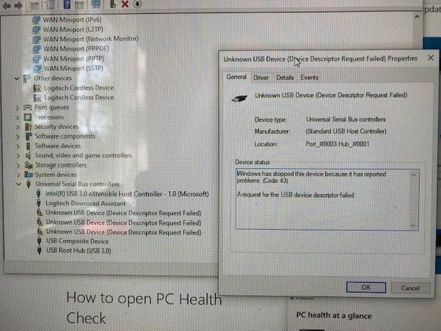

Sincerely hoping someone can help me.  Two of the three USB ports on my Pavilion AIO desktop are not working.  I use the USB ports for the dongles that enable my mouse and keyboard.  Right now, only the center port works.  When I insert a dongle into either of the other two, I get a message that says, "USB device not recognized.  The last USB device you connected to this computer malfunctioned, and windows does not recognize it."  I've tried pretty much everything recommended in other posts: Windows updates, BIOS update, scan for hardware changes, etc.  When I go to Device Manager and the USB controllers, I see yellow triangles containing exclamation points; when I click on one of them, I get the report of a Code 43 error (see pic below).   When I do a search for drivers, I get the message that "Windows has determined that the best driver for this device is already installed."  And when HP did an automated assessment of my computer, it said all drivers were up to date.   Any suggestions would be greatly appreciated!
This is possibly a weak battery problem unless a USB flash drive also fails in the same ports.  Please read everything first before installing any drivers
You should have the following ports
You should have a total of 5 USB ports. The "middle" port that works is the 2nd half of the USB2 ports.  It is possible, though  unlikely, there is something wrong with the dongle.   Batteries last 8-9 months.  A weak battery can cause the device to no be recognized properly.

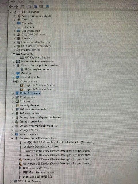

Your Logitech devices are not being recognized properly.  They are listed under "Other Devices" and should show up under "human interface devices" or "Keyboard" or "Mice.." or all three.  I also noticed that "Network" has been expanded, not just the USB controller devices.  Is there a problem with network devices?
Before replacing or updating drivers we need to make sure attached devices are not causing the problem.  You have a touch screen. Please power down and unplug the adapter so your AIO is not connected to any power.  Unplug all USB devices.  Press the power on switch a couple of times to discharge any residual electricity and then re-connect the power adapter and turn on.  Turning off and on the power resets any overload protection for USB ports.

2)  I'm sending another screenshot (see below).  I've closed the Network Adaptors, as there were no errors there.  As you note, there are two Logitech cordless devices with errors.  I've also expanded Keyboards and Mice so you can see what they look like.

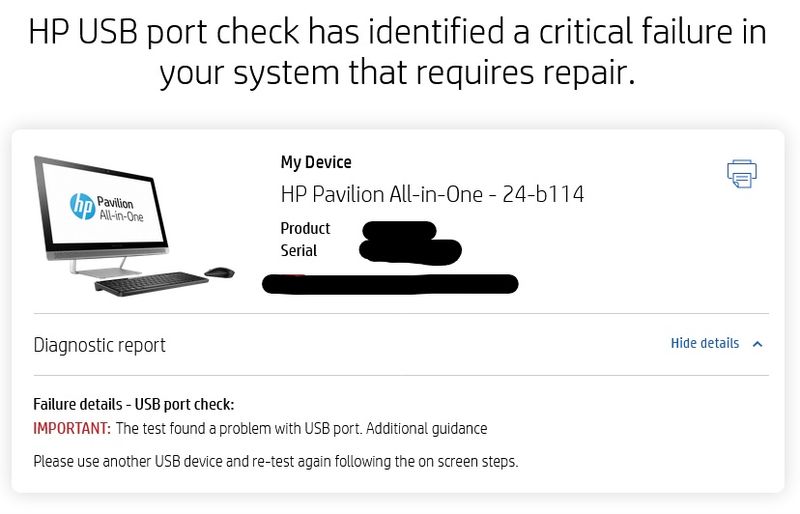

Another update: I ran an HP Hardware Diagnostics Tool, specifically a 'USB test'.  It reported a "Failure ID" of  PLJPMD-000BL0-GXPQQ1-8D0L13.  When I clicked on the Next button, I was brought to this screen:
Does anyone have any idea whether this is something that's fixable?  My understanding is that USB ports really can't be replaced.  I was really hoping this could be fixed by some sort of software update, but no such luck.
Another update: I ran an HP Hardware Diagnostics Tool, specifically a 'USB test'.  It reported a "Failure ID" of  PLJPMD-000BL0-GXPQQ1-8D0L13.  When I clicked on the Next button, I was brought to The screen shown below.  Does anyone have any idea whether this is something that's fixable?  My understanding is that USB ports really can't be replaced.  I was really hoping this could be fixed by some sort of software update, but no such luck.
InkedScreenshot 2023-05-08 at 17-03-41 HP Customer Support - Service Center.jpg
Yea, seems to be a hardware problem.  Use magnifier and light to look into the port for debris or corrosion.  I have flattened a q-tip with a hammer then dipped it into denatured alcohol to clean a USB port..  Lightening ports on iPhone are even harder to clean.
I recommend you get a powered hub.  If you get USB2 hub then use that middle USB2 port (if it works).  A USB3 powered hub may be best choice but make sure it does not slow down when USB1 or USB2 devices are plugged in (backward compatible)
You  might try wiggling the port to see how sturdy it is.  Ports can break their solder connection easily like when tripping on a USB cable.  Put in a USB flash drive and wiggle it and see if the device manager disconnects then reconnects.
