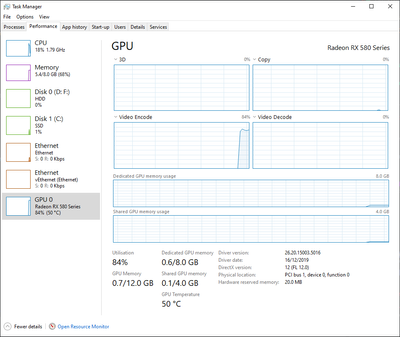

Shared GPU memory.pngAh, sorry if this is unrelated, but my BIOS actually allocated half of my RAM (which is only 8GB) to my graphics card (as seen in a screenshot from task manager). My GPU is an 8GB RX580 so having 12GB of ram at the GPU's disposal but only 4GB left for everything else is causing some problems for me. I was also aware of that option in the BIOS from reading the manual but it isn't there, regardless of whether the integrated graphics is turned on or off. I also tried updating the BIOS (although it was already on the latest version) and the option still was not there.
Is there a solution to this?
