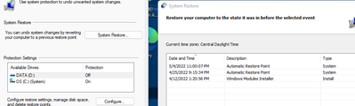

If the above does not work (battery is still missing) then  see if there is a restore point to allow you to return to your system when it was last working correctly.
Type "restore" into the windows search then click on "system restore" and select a restore point
