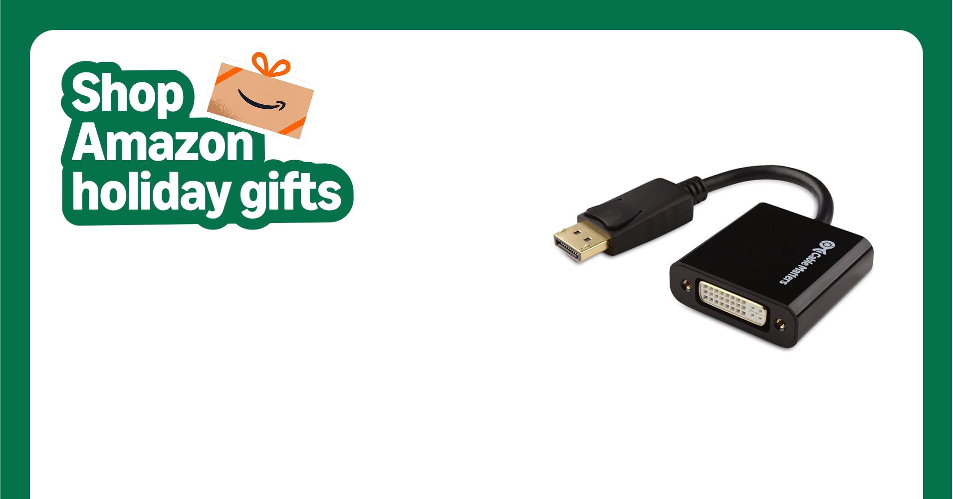

Thanks for the suggestions. My BIOS and graphics driver are up-to-date. Unfortunately, my BIOS Setup Utility does not have an Advanced or Graphics Configuration section. I went through all the available sections and options, and could not find anything related to the display. I guess I'll have to buy an active DisplayPort to DVI adapter. Can you recommend a brand? Mixed reviews for several on Amazon.
Thanks. I didn't see that one because I really need it to arrive tomorrow, and that cable wouldn't get here until Thursday. I only have through Wednesday to return the PC to Best Buy and decide on a few related items. While I doubt I would actually return it after spending most of the past 10 days installing software and data files, I'd feel a lot better about the my first HP PC if it was working like my old Win 10 PC, which can't be updated to 11. I ordered the Tripp Lite active adapter at twice the price, which arrives tomorrow. It's returnable, so if it works, I might buy the one you suggest and, if that one works, return the Tripp Lite . Keeping my fingers crossed!
Okay, I wish you all the luck!
The active DVI to DisplayPort cable did the trick! Thanks very much for taking the time to provide detailed suggestions and letting me know about active vs. passive cables. I'd never heard of that before and would not have tried it without your help.
