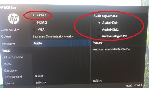

In the monitor panel there is a menu' "Input"  from there I can select Audio and the audio volume and audio internal self test.
There is an area  Audio Follow Video  where there is selected Audio HDMI1, then other option are Audio HDMI2  and the Audio Analogic PC that I cannot access.

About the area that i cannot access, I've seen that if I set HDMI to HDMI2 it set to HDMI2 if I set VGA it set Analogic pc audio, so this is not the problem and anyhow audio is not working also when is set to VGA

I did the following test again:
I discovered the following thing:
if I connect the cable via HDMI and the analog audio cable the audio cannot be heard and the monitor is in this mode:
if I connect the VGA cable and the analog audio cable the audio works and the monitor is in this mode:
e0ec73f5-5c20-4f7d-b592-41166e584053.jfif
Is there any way (for example software that acts on the monitor, on the monitor firmware) that can allow HDMI video connection and audio connection via analog cable at the same time?
