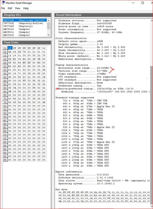

knowing that , my linked up eDID app below ( shows what you have)

but this is  what happens, in ALL OS,  the PC (or xbox) sends out a command to the monitor on the eDID pin to the EDid chip in the monitor and guess what this edid table has all the facts you can not see in the silly manual.
the eDID chip shows all things the monitor can do, if xBOX likes what it sees it can do all those modes.
see this APP, see this run this and see all the facts just one program app , free and 100% safe
https://www.entechtaiwan.com/util/moninfo.shtm
here is my old View sonic,
the Xbox must like what it sees here, IT MUST, if not ask MS why not. (gpu card limits or OS limits , i could never guess)
now you know what eDID does,  the plug and PLAY info chip seen in ALL MODERN monitors made.
Pins 13 to 19 on the HDMI cable must be correct ,no missing or bent pins or PnP can fail easy,  modern cable is BEST !!
also hot swap cables can fail, boot the PC cold to get full resolutions do not hot swap cables and wonder why it fails.
You now have the power to see why it fails  hardware is 1st then MS XBOX limits is 2nd.

I call XBOX foul ! but  use the app above, and see if there are holes  in the  MATRIX. (what if there are older versions of this  monitor that is missing support there)
The VESA rules set this, up, if XBOX does not comply with the VESA rules, it fails.  HP is not MS.
