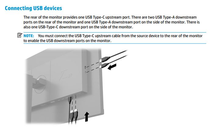

Hi,
We have 16 HP Z24n screens here at work which have their own usb output when connected with an usb-c cable on the bottom of the screen. Problem is that none is working.
We attached the usb-c cables (we tried several) to the bottom port of the screen (as the manual says), but we have none output on the usb-3 ports. No data or power.
Anyone knows what we are doing wrong? Desktops are fairly new HP's (CAD) with NVIDIA Quadro P2000 video cards.
Thanks!

12-02-2019 03:35 AM
Well, we figured it out ourselves.
The monitor is standard set to 'Power saver' which disables the USB C-port. By setting it to 'Performance' it works.
Very confusing HP! It is also not mentioned in the manual (maybe somewhere, but not where is should be).
Steps: Menu - Power Control - Power Mode - set it to 'Performance'.

11-22-2019 08:10 AM
Well, there are usb ports on the displays and we want them to work so we can connect things like charge cables, data cable for a camera for example or other usb devices.
Sorry, don't know what else I should say about it.... See picture from HP manual.
CAD stations: HP desktops specially designed/configured for CAD (like SolidWorks).
