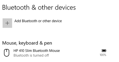

Please can someone help. I have been using a mouse via bluetooth without any issues until 2 days ago, when it stopped pairing, and it seems that I no longer have bluetooth capability on my PC.
In Settings > Devices, it tells me that bluetooth is turned off, but there is no toggle button to turn it on. In Device Manager, I have the driver Intel(R) Wireless Bluetooth(R), and Windows is telling me this is the most up to date driver. I have tried to uninstall, but it makes no difference after a restart. I don't know if this is related, but when I enable the device, Device Manager keeps refreshing every 2 seconds, but when I disable this stops.

Hi BeemerBiker
Thanks for your post. The issue I have is that I don't even have Bluetooth as an option. There is no toggle on/off button. It just states that bluetooth is turned off and no option to turn it back on:
It's like the drivers have disappeared, but Windows is telling me that I have the most up to date drivers!

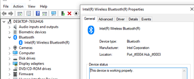

Currently the Bluetooth driver is disabled. If I enable it, Device Manager refreshes every 2 seconds or so, but it does say that the device is working properly:
What do you mean by "refreshes every two seconds"?

When I go into Device Manager, I see the below (the arrow showing on Intel):
If I right click and select properties, I get the following telling me it is disabled.
After I enable, the list in device manager, constantly flickers or refreshes, so it seems there is an issue when I enable the driver?

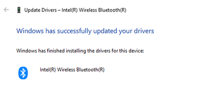

I will try the drivers, but once I have downloaded and installed what do I do? Windows keeps telling me the best driver has already been installed, and it's the previous one. Can I overwrite it?

Ok, so I have tried your suggestions. I already had the driver that Paul suggested, so I deleted them and reinstalled which has made no difference. I am connected via ethernet so I removed the drivers too.
