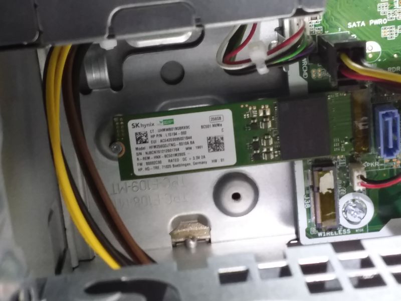

Just got my new Pro Desk 600 G4 SFF desktop, and it was advertised as having Bluetooth, WI-FI (or WAN) as well as LAN (LAN is working).  Now I started by going to windows update and ran two different update sessions (I started off at Windows 10 Pro 180something, not sure what) the second bout of updates did the upgrade to 1909, but have yet to see any Bluetooth, or Wi-Fi (I have tried clicking on the "connect" icon but with no success. Just says turn your Bluetooth on. Tried a "cold " restart, that didn't help. I did download a Bluetooth driver in hopes that it would work. Got the driver from the HP support page,  it was the Intel Bluetooth driver 21.70.0.3 Rev.A dated Feb 27 2020. It was installed at C:\SWSetup\SP 101769 with the help of the HP download and install assistant. Any help will be greatly appreciated. I plan on calling the vendor today to see if they can help, but not sure if that will produce any results. By the way, the network card is listed as Intel (R) Ethernet Connection (7) 1219-LM and is the only network card listed in the device manager. I did look in my update history and it says (1) feature update to 1909 and (1) driver update (Synaptics Media driver) which is strange cause I did 2 update sessions so far. Help please, I need my Bluetooth and Wi-Fi. I specifically got this unit partially for these attributes. Got a late start but have been up all night, so I'll catch a few zzzz's and check back before I call the vendor. Thank You so much (in advance) for any help I can get! Hope I did not get shorted some hardware!

Hi, Thanks for your interest in helping me. The product number is:4HP17UT#ABA    I found an HP document that describes features for this model and form factor (ProDesk 600 G4 SFF Business PC). It describes the ports and what is what on the outside and inside. It describes as follows for what I believe to be the pertinent hardware: (2) M.2 (1 as M.2 2230 socket for WLAN/BT and 1 as M.2 2280/2230 Socket for storage. I did not notice an external antenna by the way, and I did open the case to look inside. I did see what looked like an integrated card in the shape very similar to a RAM stick, just smaller and a little skinnier laying on it's side, and integrated into the MB with no discernable pins like on other card types. Funny thing about it was it hanged off the side of the board a bit (about 1.25"-1.5") and was held up by a screw strut where it extended beyond the board. it was not facing towards the back of the case but to the side, so it's not for some external connection. I've updated a few of the bios and uefi or something like that (I know that's wrong) drivers using the support assistant, but still no BT or Wi-Fi. I thought maybe if the card is integrated it might have been what was needed but no luck. By the way, bought from New Egg, and it was fulfilled by Deal King out of Oregon I think (at least that was the shipping origin). Thanks again for your interest in helping me, I really appreciate it. Still have not slept yet, I would like to get this solved before I do if possible. Here is the link to the product page where I bought it :  https://www.newegg.com/mr/04038120B7F38A57A4643FBC6DBDC9BB/1D2A00C18EA2D722440B9DA26098B0C5A4A375895...

M.2 PCIe x1 2230 (for WLAN)
Intel 9560 802.11ac 2x2 with Bluetooth M.2 Combo Card vPro
Intel 9560 802.11ac 2x2 with Bluetooth M.2 Combo Card non-vPro
Realtek RTL8821BE 802.11ac 2x2 with Bluetooth M.2 Combo Card
Realtek RTL8723CE 802.11ac 1x1 with Bluetooth M.2 Combo Card
On the other hand, I am not sure, but with the product number I found two models on the net (not searched beyond it is long) ..
And there is no mention of wifi!
If there is a card it must be visible in the M2 slot

hp prodesk 600 G4 M-2 2230 wlan-bt.jpg So I finally was able to determine that the vendor did not include the wlan/bt card as it was advertised as having. I am going to have to buy a card, and they will reimburse me for the purchase. The only problem is there is no spacer or screw to hold down the card, nor is there any antennas available. Would you happen to know a good place to find this stuff? I want to thank you for your persistent help with my issue. I really appreciate your time and effort helping me solve my issue. Sorry for the delayed response, as I had to deal with the vendor a bit before they agreed to reimburse me for the cost of the network card. They wanted me to send the computer back for a refund, I told them that was not going to work. They advertised the computer as having this hardware, I paid for it, they needed to get me my hardware. So after dealing with numerous people, and threatening the Better Business Bureau on them, they decided to stand by their word as far as what they had advertised what they had for sale.

Unfortunately, no, I have never made this type of purchase, maybe it is sometimes supplied with the card.
If the pc is not equipped with origin, it is necessary that the manufacturer, provide what is necessary, it may depend on the models!
