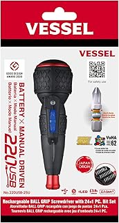

I've had problems with Japanese screws. Not that they're metric, but they use a Japanese Industrial Standard (JIS) screw head and I stripped some screw heads on laptops and amateur radio equipment until I learned that they're not Phillips heads though they look like it. Get one of these and your stripped screw heads might still have enough grip left in them for this to work:
https://www.amazon.com/Bessel-Vessel-Difference-Screwdrivers-No-220w-3/dp/B00E55DL4I/ref=sr_1_6
