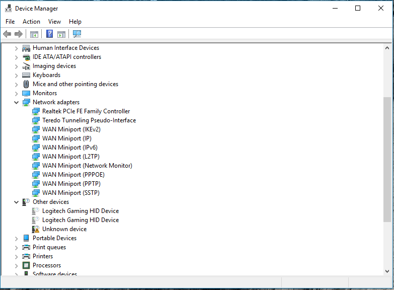

The problem is with the wi-fi adapter, because it is no longer in device manager, so I can't update it too. I already went to the HP website to re-install my network driver but that doesn't do anything (I think it's the Qualcomm one, not sure)
This is how my device manager looks at the moment...
A week ago, the wifi adapter was still there but just hidden, now it's completely gone.

Okay I tried that and this is the situation now
Maybe I'm doing something wrong when I download the network driver from the HP website?
I have uninstalled and reinstalled the network driver already last week and then it was back, now it doesn't seem to show up anywhere... unless it's the unknown device.
When I open properties for the unknown device, this is what it says:
The drivers for this device are not installed. (Code 28)
To find a driver for this device, click Update Driver.
Updating the driver doesn't do anything...
