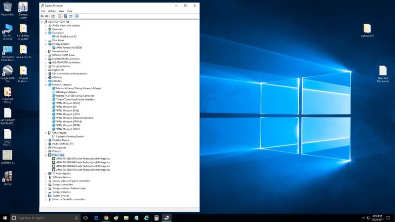

device manager showes network adapters and opening that up showes
9 things in total and then if i show hidden files then 12 things show up in total and the RAS Async Adapter shows in a translucent way showing that something is not right with it and then checking the details on it says
Currently, this hardware device is not connected to the computer. (Code 45)
To fix this problem, reconnect this hardware device to the computer.
not sure how to get maker and model of wifi adapter card? without opening the computer up and trying to read the fine print.
i just tried using Speccy and only showes network card but not wifi.showes wifi is turned off.
