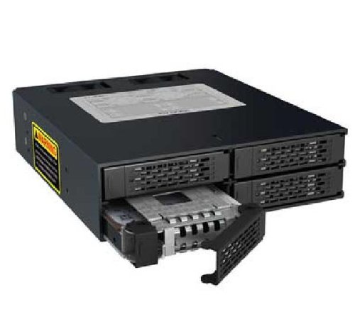

We also tried some of the dual drive ones (http://www.amazon.com/gp/product/B0047PHPTS/ref=oh_details_o07_s01_i00?ie=UTF8&psc=1), lets you put 2 SSD into one sled, with the ability to even RAID0 them, but the I/O is limited to SATA II speed...
And for the scatch filesystem on our Z820, we use 4xSSD in RAID0 on these little babies: http://www.amazon.com/gp/product/B0040Z924Q/ref=oh_details_o00_s00_i01?ie=UTF8&psc=1
