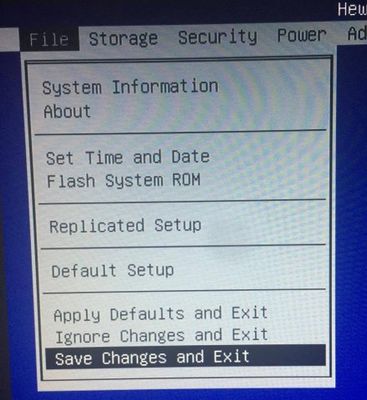

03-22-2017 06:55 PM - edited 03-22-2017 09:54 PM
Thank you again for trying to help...
Following the instructions on the link you provided, i was able to open the Computer Setup Utility. However, the instructions say to select the security tab then Secure Boot Configuration.
I dont have "Secure Boot Config" option Mine looks like this.....
Setup Password
Password Options
________________
Device Security
USB Security
Slot Security
Network Boot
System IDs
_______________________
Master Boot Record Security
System Security
Drivelock Security
From system Info screen...
HP Compaq Pro 6305 SFF
Processor Type AMD A4-5300B with Radeon HD Graphics
System Bios K06 v02.04
03-23-2017 06:32 AM
will it be possile for you to click pictures of each tabs and post it here.
mask the system details - like serail number etc. so that your identity is concealed in this forum.
This will help me to guide you better.
NB : We have different BIOS screen and among all the system i tested i have not seen that particular screen, so would request you to send it.

03-23-2017 08:27 AM
Hello @Sally8242
Seems the pics were not uploaded properly. I cant open them.
Can you reload them again.
