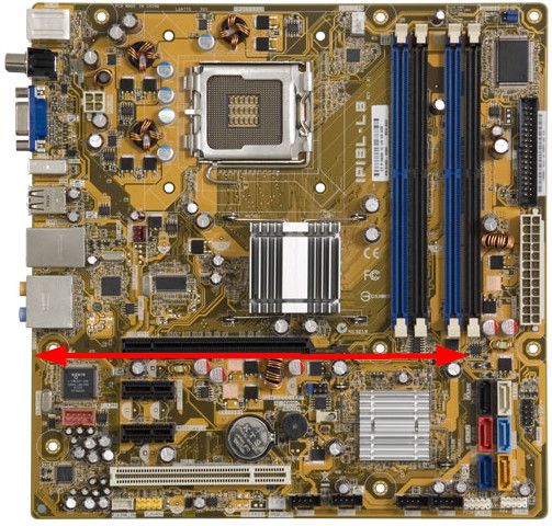

5. Open up your PC and do some measuring in parallel with the PCI-E x16 slot to see how long of a video card will fit.  The slot adjacent to the PCI-E x16 slot needs to be vacant if a wider video card is being considered.  Look carefully at the motherboard and makes sure that components on the motherboard don't interfere with the installation of the video card.  Review the below typical motherboard and video card widths as examples when taking a video card measurement.

Hi please tell me if this video card would fit my PC which is a HP Pavillion G5410UK,please tell me if it would work and fit,ah yes I already have a 650w PSU so no problem there at all.
Heres the Graphics Card: http://www.amazon.co.uk/gp/aw/d/B0047ZH7FU?is=300&qid=1334690586&sr=8-1&in=3
Thanks in advance!
Hi Ray-Tra,
You should open up your PC and measure as a double check to see in the Sapphire 6850 will fit.  It's 8.5" in length and the slot adjacent to the PCI-E x16 needs to be vacant.  It should fit but measure to be on the safe side.
