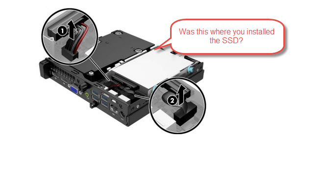

Unfortunately I do not have another computer with a slot M.2, that would check my M.2 SSD. Should the devices installed in the expansion slots M.2 displayed in the BIOS? At the your picture shown an ordinary HDD and I'm talking about disk installed in slot M.2. Maybe there are some limitations of capacity (for example, no more than 128 GB)?
OK. It could be a capacity limitation. The illustrated parts map shows only a 128 GB Solid State Drive (SSD), M.2 757990-001 unit as an option.  YOu may be better served by posting this in the HP Business Enterprise forum.
