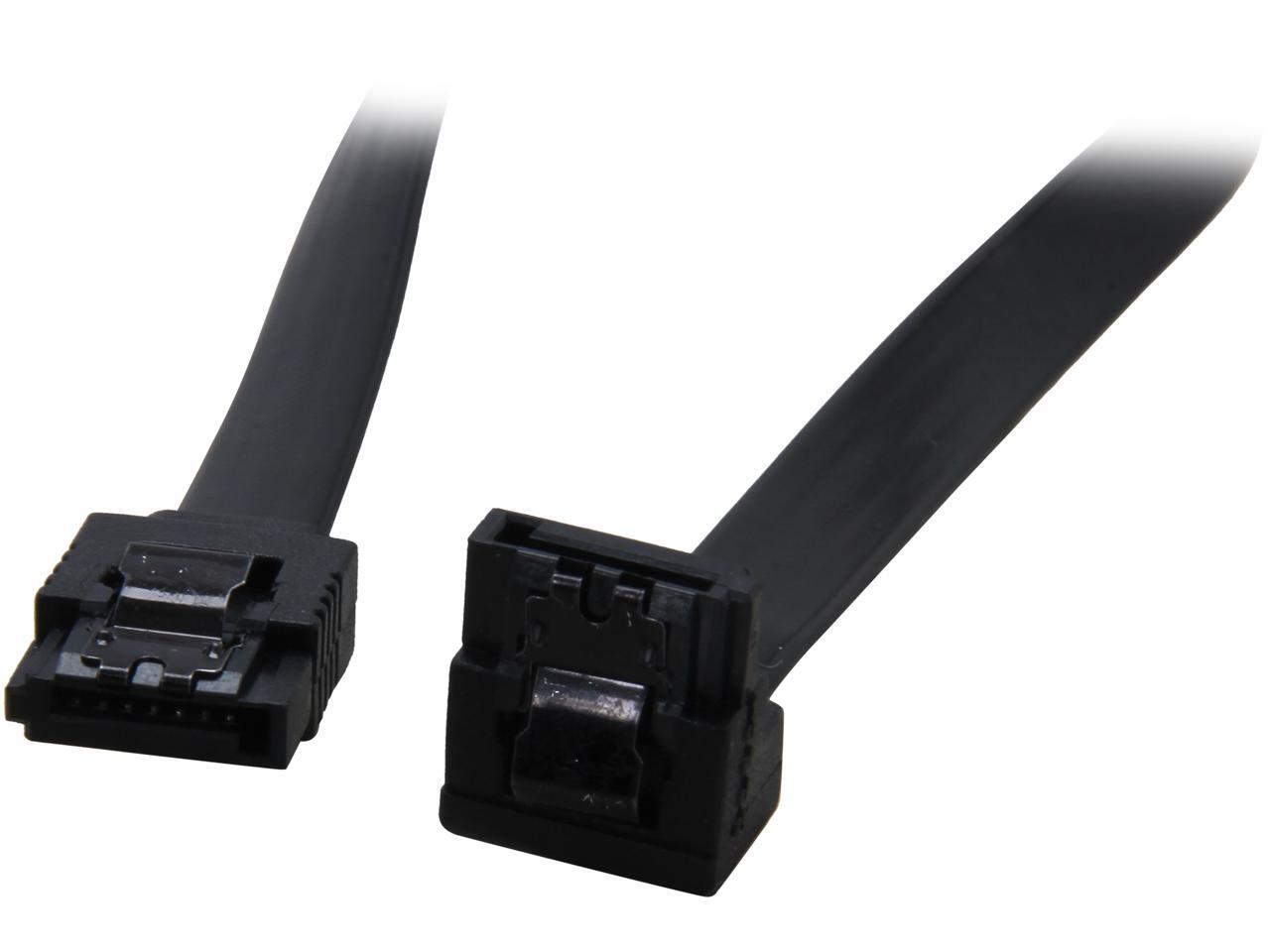

The data cable I am referring to, will not have any pins.
It will look like this...the one end will go to the motherboard, and the other end will go to the matching data slot connector on the hard drive.  That is the most common data cable.  I had no idea what those pins were for on a sata drive until now!
Now you need to know just two things...
1. Approximately how long does the cable have to be?
2. Would a straight connector on both ends be better, or one straight connector (goes to the motherboard) and one angled connector (goes to the hard drive)?
My PC's have one straight one, and one angled one because the hard drive is close to the case, and a straight connector wouldn't be able to bend enough to connect to the hard drive with the case closed.

The new hard drive does have the data connector as shown in the cable picture I posted above.
It goes right next to the power cable connection.
