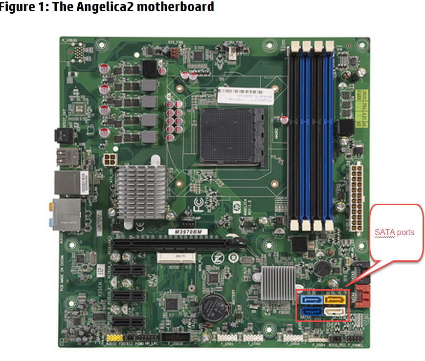

Your motherboard has a SATA controller and connectors. There are no IDE connectors on the Angelica2 motherboard.

BTW your photo that highlights the SATA connectors are showing pci-e slots for other controllers the SATA port/connectors are on the opposite side in light blue, darker blue, yellow and white with two more (reddish brown and black) just to the right of the four. So whoever said your post was a solution might need to take a closer look. Nice try though.  : ` }
Is that the motherboard that is in your system?

again thanks erico  the line above is how it was stated sorry for the confusion, I asked that it was missing not where is it. and yes that is the correct MoBo and what you have highlighted are the mini-Pci-e slots for your future reference.
Yikes! I sure did highlight the wrong slots. :smileyembarrassed: Thanks for catching it.
The SATA connectors are to the right side.
I will correct the image for others viewing this thread. Image replaced.
