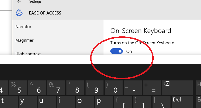

Hi,
That is not true, I'm using Windows 10 right now and you can see:
Regards.
