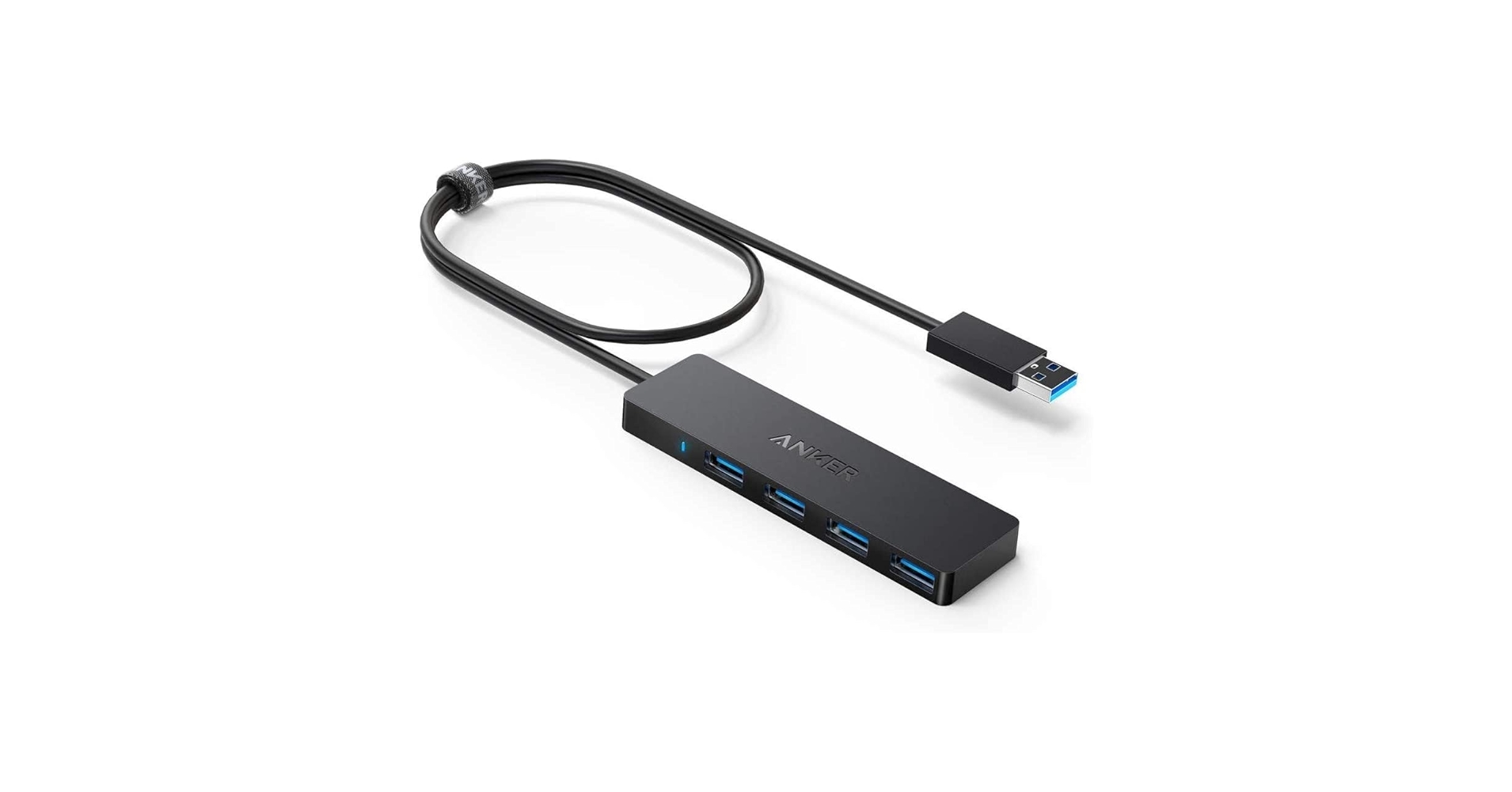

It definitely seems to be an issue with the usb ports on the X570 motherboards.  I had the same issue with my G2.  I used a non-powered usb hub built into my monitor to resolve the issue.  There seems to be more success with non-powered hubs.  Multiple people are reporting success with this hub.  https://www.amazon.com/dp/B07L32B9C2/ref=cm_sw_r_cp_api_fabt1_79-WFb4ZGWHB3
Thank you for your repley ! I will try the unpowered hub as well!
But i assume it will not fix the issue since my graphics card also has a USB-c port. Using this  would circumvent the chipset problem (like using the port in the monitor). But sadly the result is the same: a black screen on the G2 reverb. So i think it is a problem with the graphics card. That being said: no harm in trying and hopefully i am wrong 🙂
