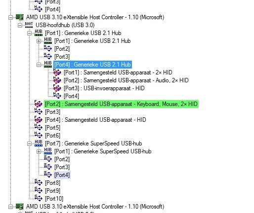

HP needs to look into this deeper, I got the same question. Got a new headset, (this my 2nd one after the first got RMA on the speakers). Worked for a second and then after a computer reboot there it was... Error 4-1 check your usb, you need a 3.0 superspeed connection..
So what I did was using a PCI-E 3.1 slot in my computer. This because the ASUS X570 Prime got issues connecting it to the mainboard itself (HP also needs to fix that still).
After connecting it to the PCI-E card I found out the sound was working, but no white light on the device and no display but only error 4-1. So bought to make sure it is not a faulty controller an external 3.1 USB hub with SS USB ports. A device my friend uses on his reverb G2 in combination with his x570 mainboard and it works perfectly.
In the next example
Using USB Tree view I can see what is going on. I have got my USB 3.0 SS hub connected to the USB3.0 controller on my mainboard.
As soon as you connect your device it connects all 3 devices to the USB 2.1 HUB.  So Port 1/2/3 are used in this case. Where port 1 is not SS but HIGHSPEED.
What it should do is show up in the SuperSpeed section on port 7 because that is the place it is physically connected to. But no matter wich USB 3 port on my computer I connect it to, it keeps showing up in the wrong USB hub.
In my friends example who has no issues he can confirm that his port 2 and 3 are used for audio and hid but then his "2 x HID" is connected to its physical location with is the superspeed usb hub.
So please HP fix your issues, you have a major problem with your devices. There must be something wrong with your USB cable that got in the package with the headset

You stated this ..
"After connecting it to the PCI-E card I found out the sound was working, but no white light on the device and no display but only error 4-1."
That points to the data cable or power brick not the headset. If you RMA the first headset and got another one with the same result the issue does not appear to be the headset.
Did they send you a new cable too after RMA ?
