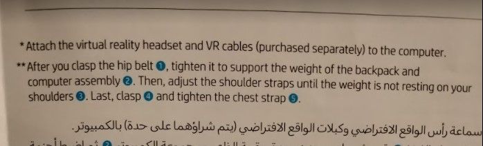

Unfortunately, this does not solve the problem.
The video you linked does not explain how to connect a HTC Vive Pro to the backpack, it explains how to connect an Windows Mixed Reality HMD to the backpack (the required cable for that is also not included in the box by the way).
"(if you've already done that and yet find that there's something missing) please send a screenshot of the manual and exactly which cable are you referring to? "
The manual does NOT list the exact part number that is required, it simply says "attach the virtual reality headset and VR cables (purchased separately) to the computer.
"if you've got everything shown in the image below, you should be able to set up the device"
You are incorrect, you are not able to setup the device with everything shown in the image. The HTC Vive Pro requires you to power the Linkbox. The backpack as the required power port but does NOT include the cable to plug INTO that power port. The G2 backpack, as compared to the G1 backpack, also changed the SIZE of this power port so the cables (that came with the G1) do not fit.
"If there's a specific part you wish to order, simply use the service and maintenance guide to find the part and order the same using the HP parts store, or any local online store as the part numbers are universal."
The only cable listed on that service and maintenance guide is for the HTC Vive not the HTC Vive Pro. On top of that, the listed cable ISN'T EVEN COMPATIBLE with the G2 backpack! The HP ZVR Backpack combination cable (part number L20517-001) has two HDMI ports (not on the G2 backpack) and the power cable does not fit into the HMD power port on the G2 backpack. On top of that, the price of that cable is listed at $195 CAD!
What we need is a power cable that does the following things:
1) One end that fits into the new plug size for the HMD Power Power that HP decided to change on the G2 backpack
2) The other end that fits into the Vive Pro Linkbox so we can power it
At the moment, I'm currently researching the plug sizes so I can order the missing required parts from AliExpress and build my own cable because HP, as far as I can tell, does not actually sell this cable. It boggles my mind that a backpack that is suppose to be designed for VR and costs nearly $5,000 CAD requires this level of jumping through hoops to get working. HP needs to be better and include the required cables in the box.
