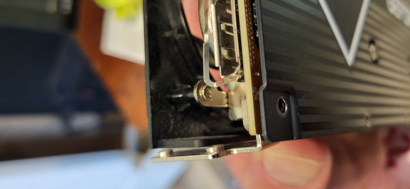

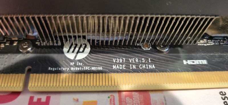

The fans on my OEM HP RTX 3060 Ti are noisy. I can acquire the correct replacements. What I can't figure out is how to remove the shroud the covers the fans. I can find videos of other mfgs 3060 cards, but the HP cards seem to have a different construction. Any help would be appreciated.

Hey, I get it those OEM HP RTX 3060 Ti fans can be tricky. HP's design is a bit different from other manufacturers, so finding a guide can be tough. Usually, the shroud is held by hidden screws on the backplate or under stickers. If you can share a few pictures, I might be able to guide you better. Let me know!"

Here are some pictures. I took out the four corner screws on the back side but they do not release the shroud. No stickers or hidden screws on the shroud side that I could see. Appears to me that the shroud is secured to the head sinks and the screw heads - while visible - are not easily accessible. I don't have a right-angle screw driver small enough to try to take these out.
I don't have a picture but I did remove the screws holding the fans in place to look for any screws that might be hidden underneath but I did not see any.
Any help would be greatly appreciated!
