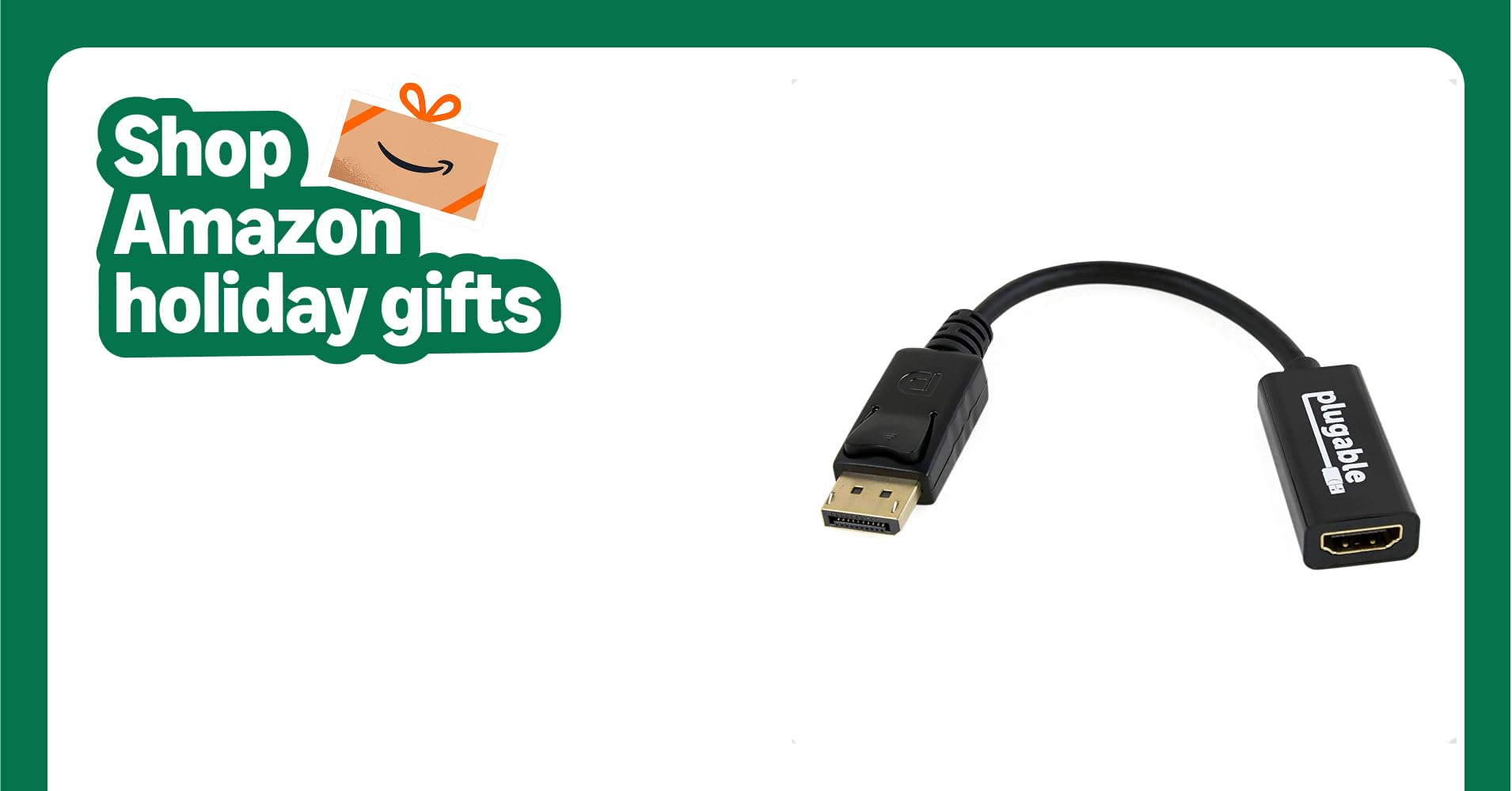

My monitors either have vgi or hdmi connections.  So I can use the one hdmi connection and then for the other 2  get 2 "display port" to hdmi converters (I don't know if they have to be passive or active)
This approach would put all three on the same card based on the layout of the metal strip on the back,  Does anyone have any experience with this particular model computer?  Is an adapter like this one ok: https://www.amazon.com/Plugable-DisplayPort-Supports-displays-3840x2160/dp/B01GW8DZV4
or do I need something more sophisticated.  Any suggestions would be great!  Thanks

That adapter will work, yes.
And yes, you have to use only the HDMI/Displayports that are on that metal strip on the back.
That metal strip is actually the ports on the 580 graphics card itself and only those ports are active. The other HDMI port/s (or any other video out ports) above on the IO shield are not active and cannot be used. They are automatically disabled when a video card is installed.
