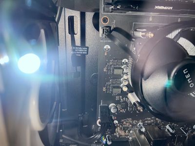

Here is a picture of my mother board. Also there is a random wire that says “rgb round fan cable” could this be used for something ?

If it is not too much trouble, please take a picture of the connecting end of the “rgb round fan cable” -which, come to think of it, should be what you would need.  As so often though, digging up information from HP's vast data bases is challenging.

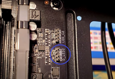

I do not have any rgb other than the normal rgb littles that are at the top of the case. Here is a picture of the cable mentioned above. It is a 4 pin and is located right under the new fan i just installed. I can find where it connects to though cause it goes behind the back
Based on the type of material used on the wire it seems it might be connected to one of these two spots. My best guess is the CN1 spot at the bottom
