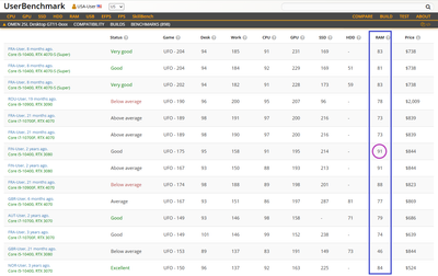

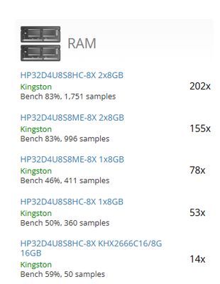

As you can see, the OMEN 25L Desktop GT11-0xxx platform is mostly fitted with HP-branded Kingston RAM:
One way to quickly ascertain which RAM performs best, is to look under the "RAM" column.  And it so happens that this particular entry shows the very-well performing non-HP RAM 2x16GB Kingston Fury KF3200C16D4/16GX:
Point is, the OP claims to have RAM running at 3200 MHz.  The only RAM I could locate in this platform running at 3200 MHz (and then only sporadically), is HP-branded Kingston RAM.  It is not clear to me how any of these Users are doing it, because only few Users show 3200 MHz running RAM.  That's why I asked the OP to run the Userbenchmark so that I could take a look at it.  You know: 'trust but verify'.
