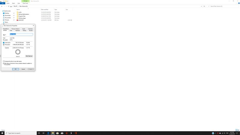

So after you installed the new SSD, you were able to boot into Windows 10. Then you used 'Disk Management' to format and assign the SSD a letter. Is this correct? Can you see the new drive with 'File Explorer?' What drive letter did you assign it? Is it showing 2TB of free space? If the new SSD is now working, are you having any other issues?
12-28-2019 08:25 AM
yes what you say is correct.
I see the new drive in file explorer , the letter is (E), and it work with out any issues.
just I found when I power on pc the boot it take longer than before.
is what I did is bad for this pc, if better remove this ssd I will removed.
and what is raid-0
12-28-2019 08:43 AM
When you boot up Windows, how much longer is it taking with the new SSD installed? Did it changed from 5 seconds to 10 seconds or is it unusually long (ex. 60 seconds).
When Windows is running, is the computer running slower, lagging, or freezing up or does it appear to run normally? Are programs running normally?
If booting up to Windows 10 is just a few seconds, Windows 10 is running normally, and there are no other issues - then it would appear the new SSD (Drive E:) is working fine with your system.
RAID-0 is where two physically separate disk drives are combined as one drive and assigned the same drive letter.
12-28-2019 09:32 AM - edited 12-28-2019 09:37 AM
If the SSD was 71 degrees C all the time, that would not be normal. However, when you perform a 'performance benchmark' the temperature of the SSD will increase as it is tested. When the test is over, the temperature of the SSD should decrease back to normal. I assume you removed that rubber strip that was mounted on the motherboard behind the black cover plate when you installed the SSD. That strip should be removed for better airflow.
Take a screenshot of any additional performance benchmark results. We would love to see it.
