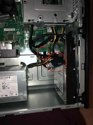

My PC has a PSU labelled as part number L63964-004
My model isn’t shown on that spreadsheet
I’ve attached pictures of my PSU’s setup. It has the two 2x2 pin connectors and a small 7 pin connector to the motherboard and theres a long flat connector, a 2 pin connector and a 6 pin connector which aren’t being used by anything.

Look here, is it a 6+2 PCIe.   To 2 pin should be molded to "create"  an 8 pin.
If this is true, you have filled in an unknown and I will include it in the next update, also adding your unit.
The 2 unused plugs in the last picture resemble SATA power and the 2pin of the 6+2 .  Once you verify that plug, I will have to create a whole new column for page 2 to be accurate.

I can confirm that the unused connectors are indeed a SATA connector and the PCIe 6+2 connector.
i’ve decided to go for the L04618-800 400w PSU as it is the PSU which comes with the TG01-0011na which has the exact same specs as mine apart from a 1660 ti graphics card.
The 1660 Ti requires 125W as apposed to 75W for the 1650, so 90W extra should be plenty for my needs.
Thanks for your help
